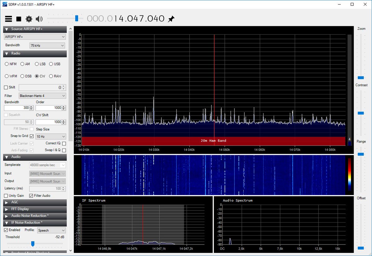

Дата: 19 Фев 2017 15:08:45 #
Скрин
20m is quite readable with a small whip antenna
