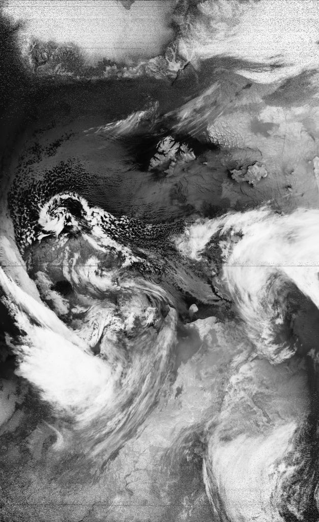

07.12.2021 09-55мск NOAA-19
FULL
WEB
07.12.2021 11-25мск NOAA-19
FULL
WEB
