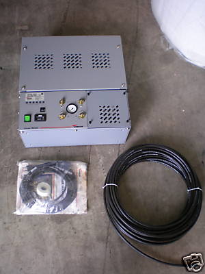

Неоднократно натыкался в Интернете на сабжевое оборудование.
Инртересно, есть у нас кто в РФ, кто устанавливал/пользовал? Расскажите что-нибудь про это - интересно ведь :)
Уровень ПДРЦ не интересует, а вот системы ПМР (оч. сомневаюсь что у нас кто-то раскошелся на это) и сотовой связи - это уже интереснее...
Есть вообще такое?

Вот, допустим, фото:
И брошюра.
В описании вопрос применения вообще не затронут...
Для чего юзают? Для микроволновых волноводов, типа вот этих:

Да с теорией более-менее ясно. Вот, например, про девайс с первых 2 фоток:
PMT200 Theory of operation.
The PMT200 series of DryLine dehydrators, while similar in moisture removal technology, operates differently than the rest of the DryLine series of dehydrators. In order to provide a constant supply of dry air to small air volume systems, and to maintain an acceptable dryness level in the product air stream, a high-pressure reservoir tank is utilized. This reservoir tank is connected to a pressure regulator and orifice to yield a fixed output pressure of 5.0 psi and a nominal flow rate of 0.2 SCFM. In addition to supplying the output air, the reservoir tank also provides the dry air for the feedback loop. The feedback loop is necessary to maintain the dryness of the membrane cartridge.
During normal operation, the bleed air in the feedback loop will cause the pressure to drop in the internal reservoir tank, and the PMT200 compressor will cycle automatically. These cycles will take place regardless of the system volume or condition of the transmission line the dehydrator is connected to. The rate of these cycles, however, will vary.
When connected to a very tight system, or the output is capped, the dehydrator will cycle approximately every 60 minutes and maintain 5.0 psi system pressure while providing close to 0.2 SCFM of dry air. A system that leaks will have a cycle time somewhere in between, depending on the severity of the leaks.
The pressure gauge will also reflect a pressure between 0 and 5.0 psi while the output flow is between 0 and 0.2 SCFM. The pressure gauge senses pressure beyond the flow control orifice and will show the actual pressure in the waveguide.
During the initial pressurization of the transmission line, the dehydrator will cycle every 2 to 4 minutes with the system at 0 psi pressure. As the dehydrator pressurizes the system, the cycle times will increase and the pressure will rise until the dehydrator output is balanced with the system leak, at which point the cycle times will stabilize.
Итересно куда на практике... какие системы, какие фидеры...
