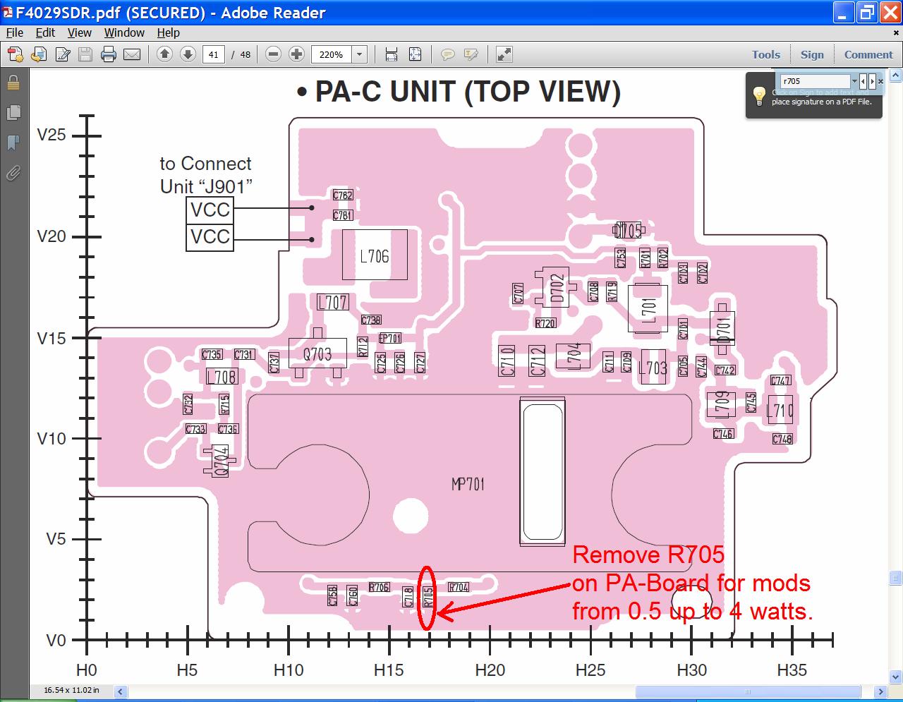

Icom IC-F4029SDR - mods RF power to 4 Watts
Разместил: supanit 1.2     Просмотров этой страницы: 5971
Скачать файл: файл jpg ic4029sdr-4w.jpg (161.1 Kb)
Icom IC-F4029SDR - Mods Rf power to 4Watts
When are you finished in hardware Mods.
You could be used csf4029adj.zip to fine adj power again.
Note: plase , No adjust Rf power more than 8.5 Watts. Because your Battery will be fasten to low on new Rf High power Transmitted .
